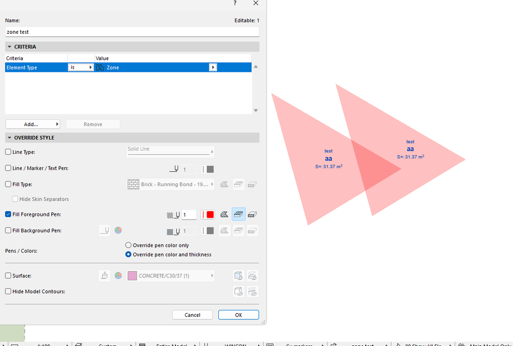

Here are zones with no GO, with their cover fill at 25%, transparent background
Now if I wanted to override them with a red hue, I just override the fill foreground.
does this answer your question?
Edit: or do you want to override just the background? I tried that and strangely, it doesn't override only the background pen.
edit2: I have tried and the GO works on any type of a fill that does not use a transparent background. if that is used, the override won't work.
