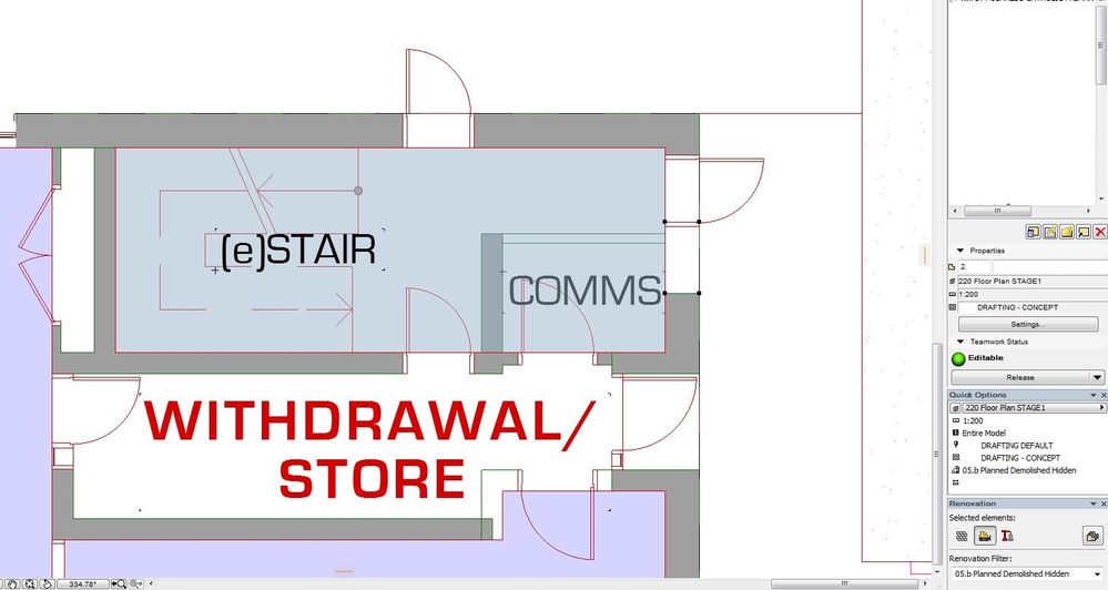

I guess this is quite a trivial question because I have a feeling that I've already dealt with it once but can't remember how, so need to ask you guys:
doors and windows that I set up as demolished still show up on the plan, even though I set demolished objects up to be hidden. (jpg attached) Is this some sort of MVO issue?
Will appreciate your help!
1 Reply 1
It is all in the renovation filter settings.
Just make sure you are using the correct filter.
