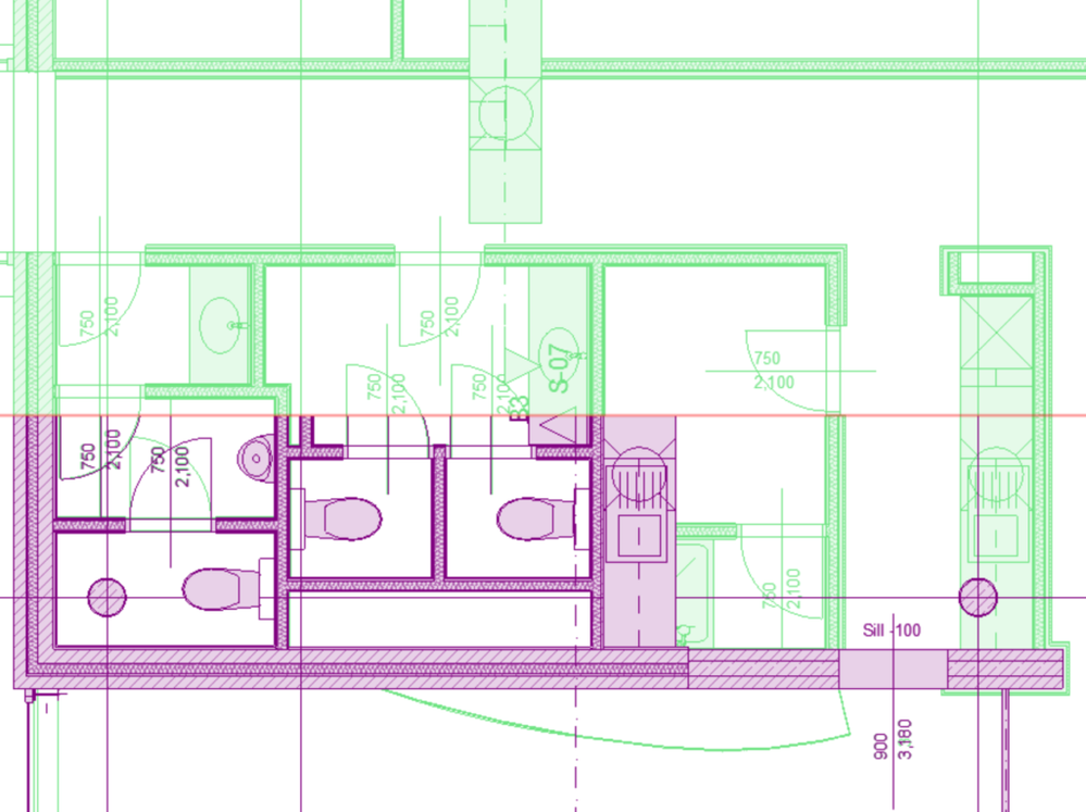

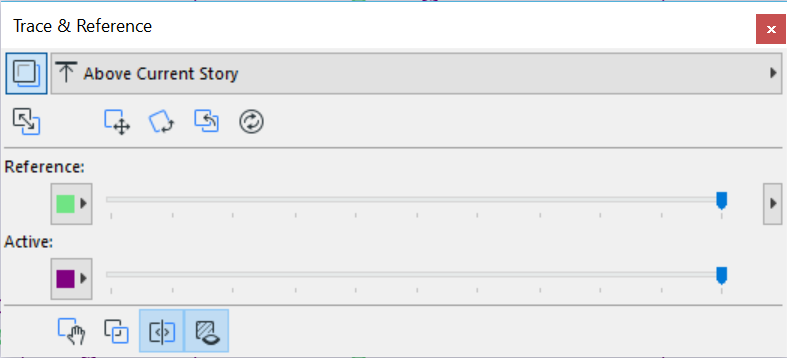

This feature helps the user identify the differences between two views. All the necessary settings are available from the Trace and Reference Palette which is accessible from the Window > Palettes menu.
Main options of the Trace & Reference Palette
  • Choose the Reference to be traced
Open a view, a viewpoint, a layout (or basically any Navigator item) this will be the "Active" content; then bring up the second one as "Reference"; then compare the two. Reference can be any item in the Project Map, View Map and Layout Book.

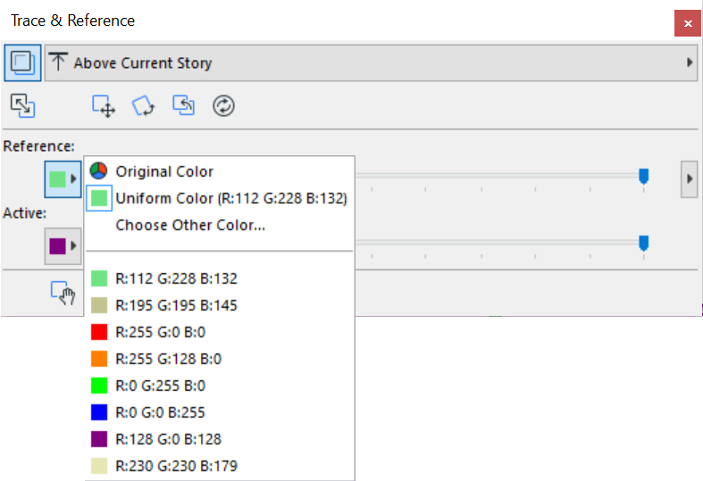

  • Set the color and the intensity for both the Active content and for Reference
    • You can use
      • The original color
      • A number of preset colors and
      • Any custom color
    • You can set the intensity of the color using the two sliders on the palette (from very transparent to intensely colored)

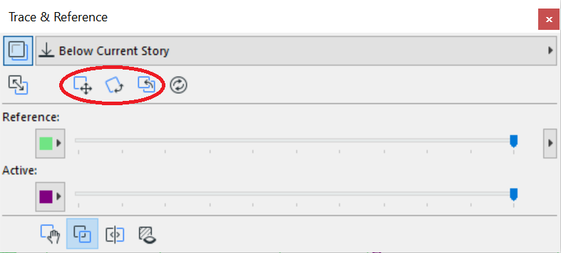

Additional options of the Trace & Reference Palette for a better visibility of the differences
  • Switch Reference with Active - this means that you navigate to the other Navigator item in the project
  • Changing the relative position of the Reference
    • Drag Reference
    • Rotate Reference
    • Reset to Default Position

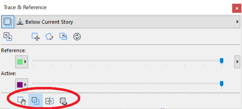

  • Display-only modifications in the position of the Reference
    • Temporarily displace Reference - for the second click of the mouse button, the Reference automatically moves back to its default position
    • Reference on Top - similar to switching between Trace and Reference, but now the same view remains active; this changes only the display order of Active and Reference
    • Show / Hide Splitter
    • Make Fills and Zones transparent
