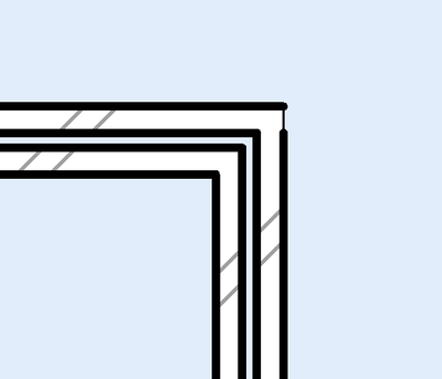

See issue with wall ends.
I have tried the settings in the complex profiles and composite profiles to turn the end lines on. This odes not help. All my layer intersections are the same.

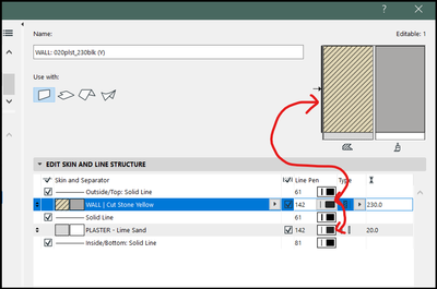

I've had the same issue and solved it by playing around with the "Line Pen" settings in the composites dialogue box...
2022-10-12 08:27 PM
2022-12-23 03:32 PM
Thanks exactly it, there is a line colour setting for the edges of the selected composit materials!
