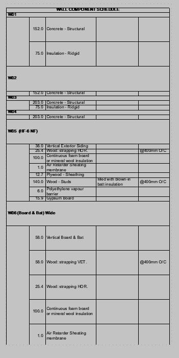

My wall schedule doesn't seem to update correctly.
With every change I make the schedule seem to revert to some predefined row & column size.
This in turn causes walls types/components to not display on my layouts.
This is how it displays after each change to a wall.

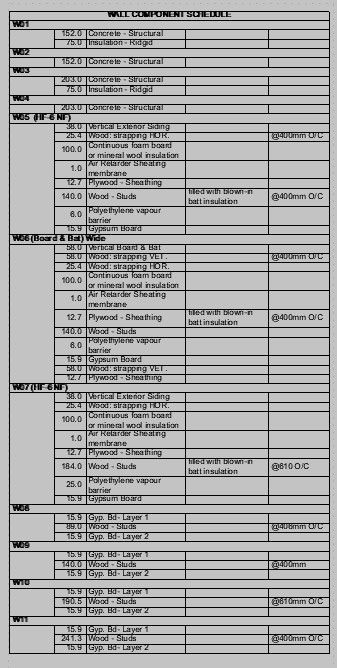

To fix it I have to:
1) Open the schedule in the view map.
2) Click "Schedule Cell Size"
3) Click "Resize Rows to fit content"
And then it updates correctly.
I'm sure there is a setting that I'm missing that lets Archicad automatically update the rows?

I have to do this too with windows and doors and such but I think the answer would be to predefine a specific width/height for the column and then it should retain that distance regardless of the changes
Red
I have had this issue as well. At first, I thought I was doing something wrong, but I could not find a pattern that was causing it.
