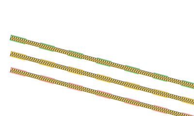

Thank you for answer. Do you know how to do line in the axis of the wall. I can make line on the circuit of the wall or fill in color but how to make color line in axis?
Marakos
I manage to make each wall difrent color just by choosing fireproof but I need to make it in axis mode.
