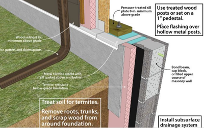

The following illustration (not from Archicad) shows approximately what I'd consider to be fairly typical basement wall construction around here (although basements are generally cast concrete as opposed to block).
I'd like to convey this information in my model and communicate it to the contractor in the best way possible.  I'm still very unclear on what goes into the 3D model and what is NOT modeled in 3D but is detailed or annotated on the 2D section views. For example...
a) Would you 3D model the thin sheet metal flashing used as a termite shield?  If so how do you do this assuming it's like 1mm (.040") thick?  If you do model this in 3D, would you put this in the basement wall complex profile - make it its own complex profile or do it some other way (that I don't understand!).
b) In general - how do you model thin profiles like membranes? Do these appear in the 3D model or are they only noted in a 2D drawing?
c) I keep hearing reference to people "modeling" things like joist hangers and threaded anchor rods. Forgive my ignorance here but I haven't figured out how to draw up discrete components such as these in 3D in Archicad!!  So far the only thing I've done in Archicad 3D are extruded profiles such as walls and beams. How does one create and place 3D models of these - or are these not modeled by the architect/engineer but downloaded from some library someplace?
I really appreciate the insight - seems like there are a million ways to do things with tradeoffs and I really value learning from people who have consider them and the implications.
Thank you!!!!
My approach would be as follows.
a) Depending on the complexity of the building and the number of details you were wanting to cut through it would determine if it was modelled or not. Based on the detail above I wouldn't model it, as it wouldn't be seen in my sections, as it is too small. But if you were going to cut a lot of details at a large scale, then model as a separate complex profile on top of the basement wall. That way it can be separately labelled with autotext calling out its profile name (which you name appropriately).

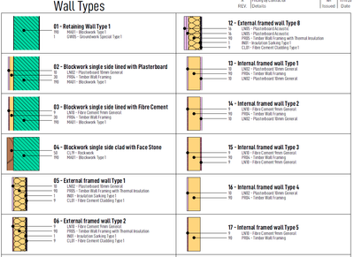

b) I will only include them in composites for walls (I then have a wall schedule that the builder can than review and know exactly what needs to go into each wall of the building.
Here is an example that I use on every project. I then have a wall label that takes the start of the Composite name to tag each and every wall.
