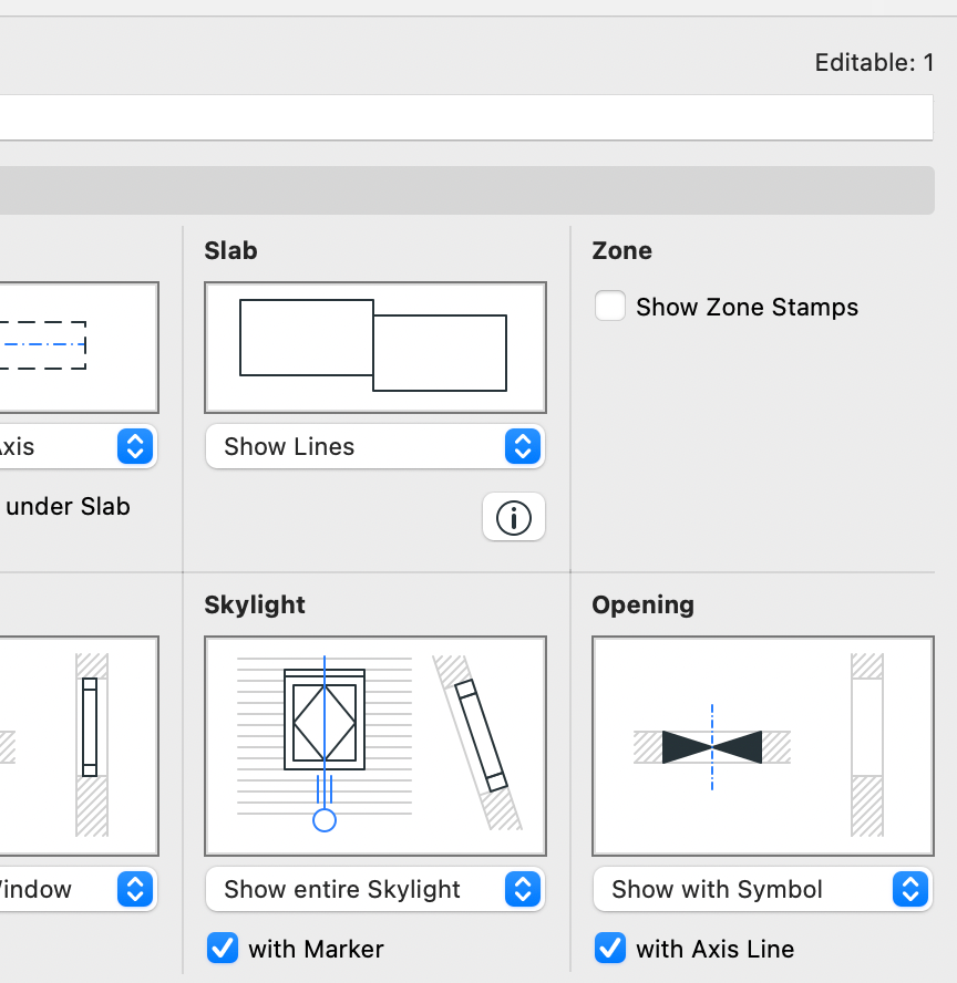

fnsgreen
Your zone layer must be on, but you can uncheck the show Zone Stamps in your model view options, then only the new label will show.
Ray
Turned off the show stamps button, but the tool still does not recognize the zone. Is this actually working yet?
fnsgreen
Make sure your layer for the zones is on.  Are you doing this in a floor plan?
Ray
Looks like an update issue. Updating to the latest build, hopefully that will take care of it!
Ray
That was it. Updated to build 4003 and the annotation option in the zone tool showed up.
