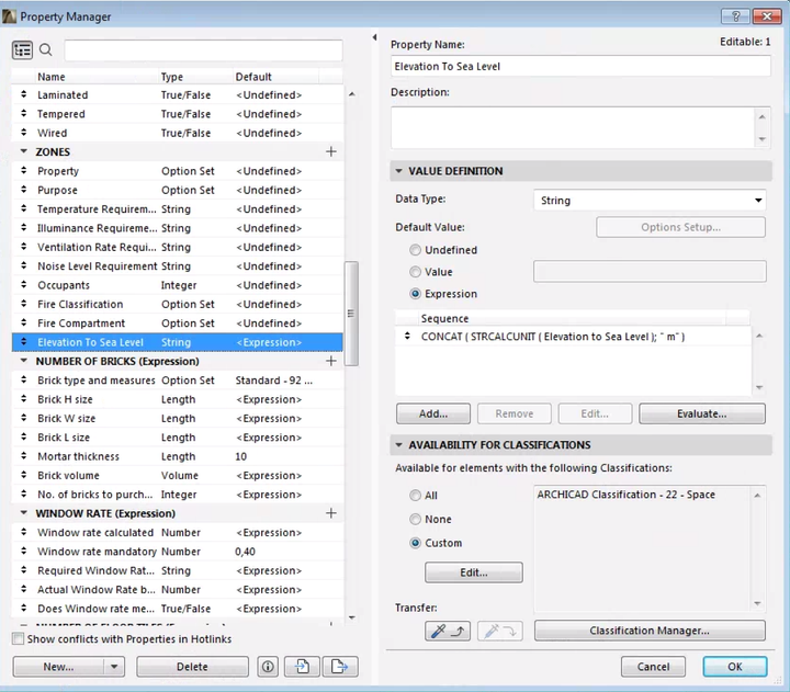

You can display Properties in the Zone Stamp.
So you just need to create a Property that will display the Zone's Elevation to Sea Level.
The attached screenshot shows the definition of the Property that will achieve that.

It should not be a plain text.
You need to select the "Elevation to Sea Level" Property from the list of available Parameters and Properties.

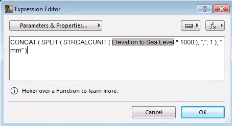

Here is a modified version of the Expression.
In the Dimension Units Dialog, Length Units have "Meters" set with 2 decimals.
So the Property would be: "6,00 m"
So I multiplied the "meter" value to get millimeters, then used the SPLIT function to cut the decimal separator and the 2 decimal places on its right side.
Converting from millimeter to meter can work similarly.
See the attached image for the Expression.

Hi LaszloNagy,
I tried your expression line but I still gets syntax error. It does not let me click OK. Am I missing something?
Thank you
