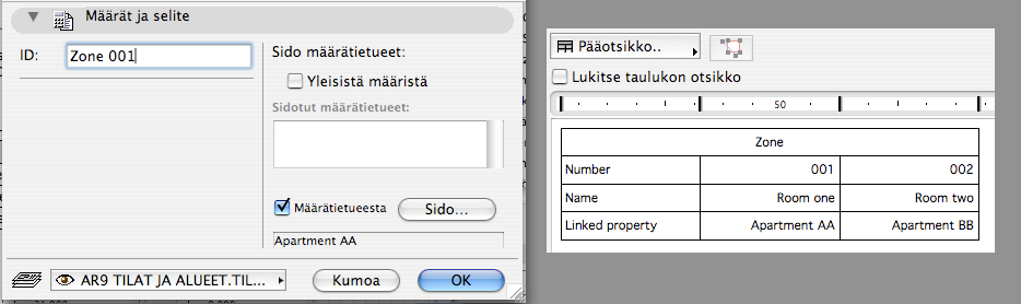

Hello,
If I understood the situation right, one solution could be linking
properties (named by apartments) to the modules and schedule that
info in addition to story, room number and room name.
Hope this helps.
Juha wrote:
If I understood the situation right, one solution could be linking properties (named by apartments) to the modules.
I never used Properties so the question will be really basic: so you can assign that to each individual instance of a module (like, place 2 identical modules, select one and make it 'apartment 1' and select the other one and make it 'apartment 2')?
Sorry Ignacio,
I thought the properties could be assigned to linked modules, but it
cannot be done - only for 'local' zones. We have used it in multi-storey
shopping centres to pick up users' zones which are widely spread around the building,
but never tested with hotlinked modules .
Hope this issue can be solved some other way.
Best regards, Juha
Juha wrote:
I thought the properties could be assigned to linked modules, but it cannot be done
Thank you very much for checking. I am starting to try to come to accept the idea of no tags or manually typed tags (like, 5000 of them) and Filemaker schedules.
