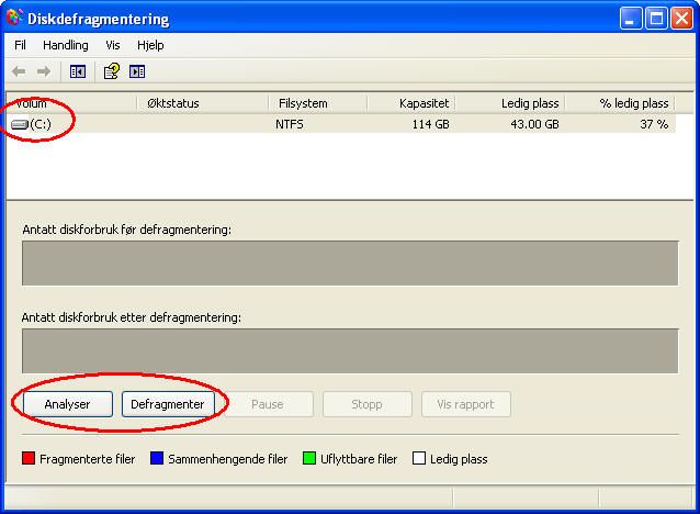

Hello Jesikuh123!
I totally agree with you that it shold be possible to have a section/elevation open and be able to go to the info box and click on the settings icon. The changes you make there should apply to the current section/elevation you are working on! Would be a lot more intuitive. Isn't that ArchiCAD is all about?
PS: Snapcrackle's guesses are reasonable. AC needs a buffer of free disk space. Save old files on a portable harddisk and defrag. That will probably solve the problem.
