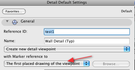

cremsberg
Yes, Marc, that helped, but Referred Drawing option was not available until I selected "With Marker reference to: the first placed drawing of the viewpoint" under General

Karl Ottenstein
Moderator Emeritus
Attached is the top of the dialog that Marc refers to.
I actually just had the same experience as you, Claire, because my defaults were somehow set for the marker to reference the "viewpoint" instead of "The first placed drawing of the viewpoint". My defaults in earlier versions were set up correctly.
That's what Marc was saying.
Once you have created the detail, you have more options for what the marker bug should refer to (attached).
