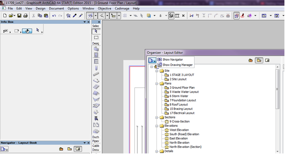

can i import a master layout from another .pln file?
16 Replies 16
It only seems to have that option on a mac. Or possibly not available on SE? Are there any windows users who know if this option is located somewhere different?
I am afraid it is not available.
In the full version you have the Browse Project command in that little list you show on your screenshot. With that command you can open another Project and show its project structure in the left pane of the Organizer, then drag-and-drop items from it to the active Project, shown in the right pane of the Organizer. This way you can import Master Layouts as well from other Projects.
However, it seems that this is not available in your ARCHICAD version. Must be a limitation in the Start Edition (If I recall correctly collaboration features are not available in the Start Edition):
