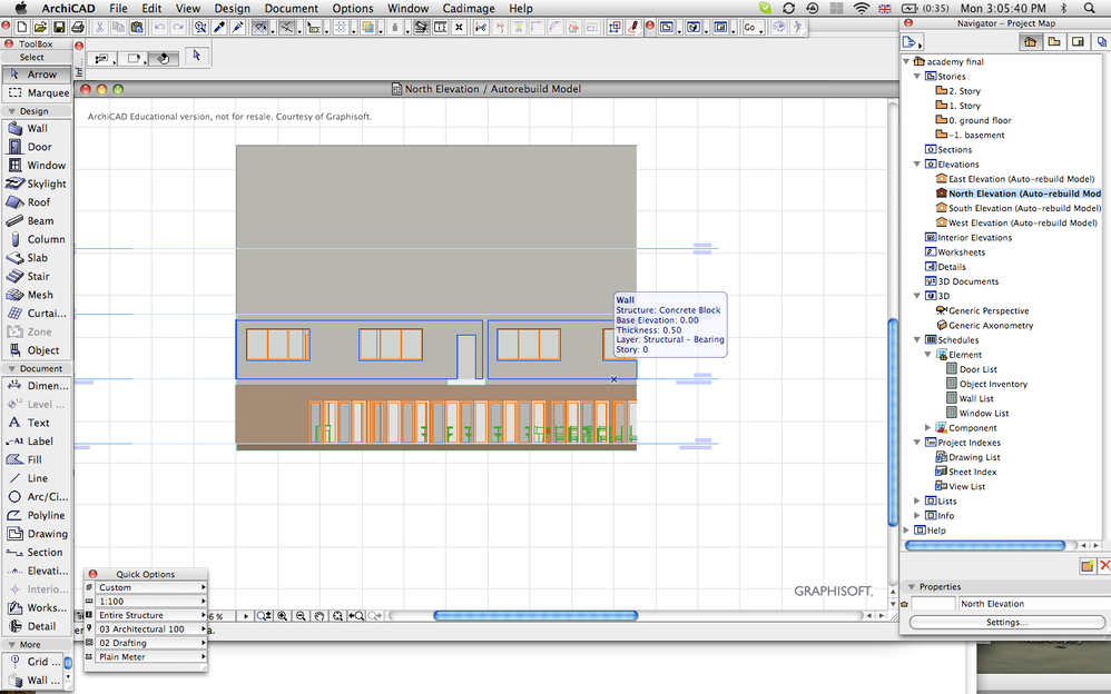

part of elevation view is always missing
can anyone help please, whenever i go to the elevations views of my building there is always about a third of the view missing, i cant for the life of me work out why. any help greatly appreciated

Hi!
when plancing the elevation "line" in the plan view make sure this line is long enough to embrace the whole elevation.

oh, thanks for that, looks like that could be it, although im struggling to find a way to adjust them to include the whole plan. thank you for your time
you could :
A-
1- select the line
2- go to one of the end points
3- strech the line ( as in the attached picture )
B- OR create a new elevation line
