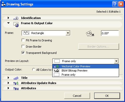

first off, please forgive me if this is a simple fix. i searched the forum and could not find a similar topic. i am very new (two months) to ac. for some reason one of my saved quickviews will not show up in plotmaker. it will load onto the layout with drawing frame and even recieves the correct title, but there is nothing inside the frame. i have turned on all the layers, tried changing the scale, and pan within the frame (all within plotmaker). nothing worked. i went back to ac and made sure the layer combo and scale was as needed and redefined the quickview. update in plotmaker didn't do anything. i even re-imported the view, and same problem. i restarted ac and pm and nothing changed. any suggestions. and again i apologize if it is something simple (actually i hope it is something simple, so i can fix it) thanks gor any help.

Set to Vectorial or Bitmap preview.
thanks for the response, but it was already on that setting. i found a temporary solution though. i just put a detail window around the view i wanted to import and brought the detail in to pm. it worked fine. i don't understand why it wouldn't recognize from the floor plan.
