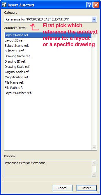

As someone at Graphisoft Budapest recently pointed out to me, first pick which CATEGORY autotext refers to, and then pick what AUTOTEXT ITEM(S) of the the selected reference you want.
First you alt/opt+click on the drawing in question.
By default the selected reference is the LAYOUT so if you pick Drawing Name, it will list the names of all the drawings on the Layout.
Instead browse the available references by clicking on the arrow (see screenshot). You will find available the drawing you alt/opt+clicked on available as reference.
Select this and then chose Name and now the autotext will only show the Name of this drawing..

Categories of autotext. Note that the Proposed South Elevation which I had alt/opt+clicked on is listed as a reference category.

_Salmon
Done!
Thanks for your fast reply.
