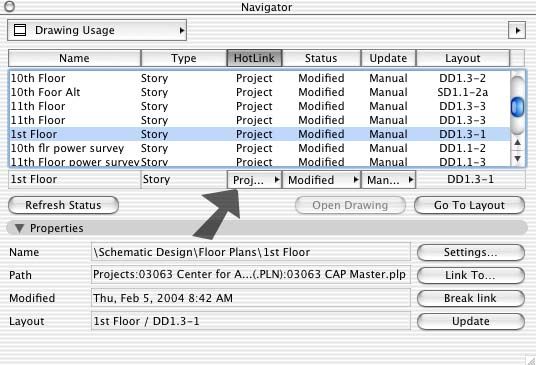

There is a way, but is not obvious. Publish your viewset from ArchiCAD to a folder as PMKs. In PlotMaker, link manually every drawing with the corresponding PMK using the 'Link To' button on the publisher (I have the spanish version so perhaps my translation is'nt fine). Once this is done, select all your drawings and change the type of link from 'Archive' to 'Project'.

Wow - no kidding! I'd have never found that! I wasn't aware that you could even change the type of link in the Drawing Usage window.
Somewhat tedious process, but it worked like a charm. If one makes the mistake I did, this will recover the links - and keep all your drawings in exactly the same place!
I think this should go into the tips section. I add the following attached image to clarify where one changes the link type.
Thanks
wes

You can re-link them simultaneously by selecting them in similar groups (all files or all projects FROM THE SAME VIEW SET) in the drawing usage navigator. If you have multiple view sets, as I do, you will have to re-link them set by set. If you have file and project links selected at the same time or if you have deleted a view in AC that is still in the PM list you may not be able to link them all to a pln. (or better a pla) while those particular views are selected. When you do them as a group they are automatically connected with the appropriate view eliminating the extra step of selecting the view checkbox in the dialogue box as you do for individual views. Very quick very easy over the one-at-a-time method.
From looking at your screenshot I would select the layout column for organizing the drawings and select all the DD drawings as a group and link to... , then the SD drawings (whatever else is the same) as a separate group. Group by group this will be much quicker than one at a time.
