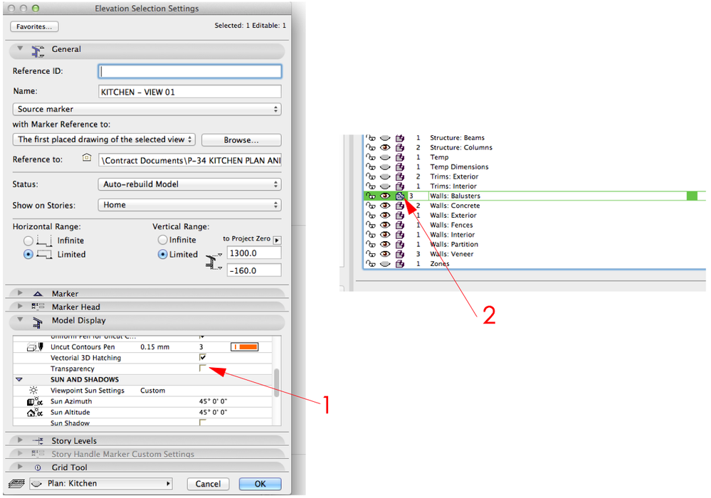

There are a couple of ways.
1 - Turn Transparency ON in Elevation settings (Model Display - Uncut Elements)
2 - Place items you want shown transparent on a specific layer set to show in Wireframe
