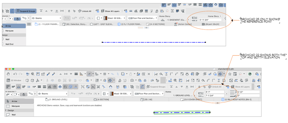

you may not be understanding what I am referring to here. please see attached pdf showing the difference between V25 & V22. V22 shows the top and bottom elevation for beam when i select it V 25 only gives the reference elevation.
I do know how to set its position when placing or if i want to relocate it but often i need to know the top and bottom position when placing other elements to it.

Thanks for sharing the screenshot.  I had launched AC 10 and back then, the top and bottom appeared in the Info Box labeled 't' and 'b' and you could even use keyboard shortcuts to jump to those value boxes and change the value to move the beam.  I found it pretty handy in the day... don't really know what version first deleted that.
AC 29 USA and earlier   •   hardware key   •   macOS Tahoe 26.5 MacBook Pro M2 Max 12CPU/30GPU cores, 32GB
OK, so what you are saying is you want to see both top and bottom heights of the beam - not just the reference height.
It is the same for walls, slabs and columns.
We have the overall height and the base or reference line offset.
We can't see the actual top and bottom heights in the settings.
I am guessing we will not get this back in the info box or element settings, so the only options I can suggest are to place an elevation label showing both the top and bottom elevations (it can be in a layer that is automatically hidden in you plan views and only shows while you are working and turn it on).
Or you can place other elements in 3D using the top or bottom of the beam and the blue temporary guides (or you can place the orange permanent guides) or you can snap directly to the beam if your element is actually touching it.
Maybe that is not quite the same as simply selecting the beam and seeing what the heights are options that don't involve calculating heights yourself.

I think this change in the Beam tool's Info Box panel is probably related to the fact that multi-segment Beams were introduced in AC23, the Info Box was changed then. Maybe it is because Top and Bottom are no longer relevant when each of your Beam segments can have different geometry and thus can have different Tops and Bottoms. In such a case, all you have left is the Beam's Reference Line location which you can still define with the Info Box field.
Ron
that makes sense however when not using a segmented beam there is no reason to not show top and bottom elevations. that feature would not be highlited when segmented as happens on other features. this missing feature is making a lot of work more cumbersome.
