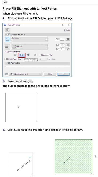

  16.  When placing a fill origin I used to be able to set the origin before laying out the fill, best method, then it became after you place the fill, now you place the fill and it puts the origin at the center and you have to find it and move it to where you want it. Every change arhicad makes makes it more difficult not easier. NOW I HAVE TO DRAW A  REFERENCE POINT TO WHERE I WANT TO MOVE THE ORIGIN TO SINCE I CAN NO LONGER SET THE ORIGIN FROM A KNOWN POINT
Apparently this was changed in version 23.  The PDF Reference Guide for 25 (page 2070 English version)  still describes the method for 22 and earlier.. with the cursor changing shape after drawing the fill outline to place the origin and direction vector.  I'm told that Graphisoft will be updating the manual.
