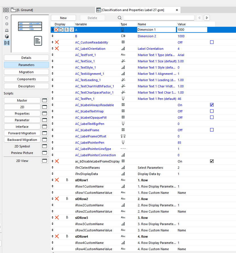

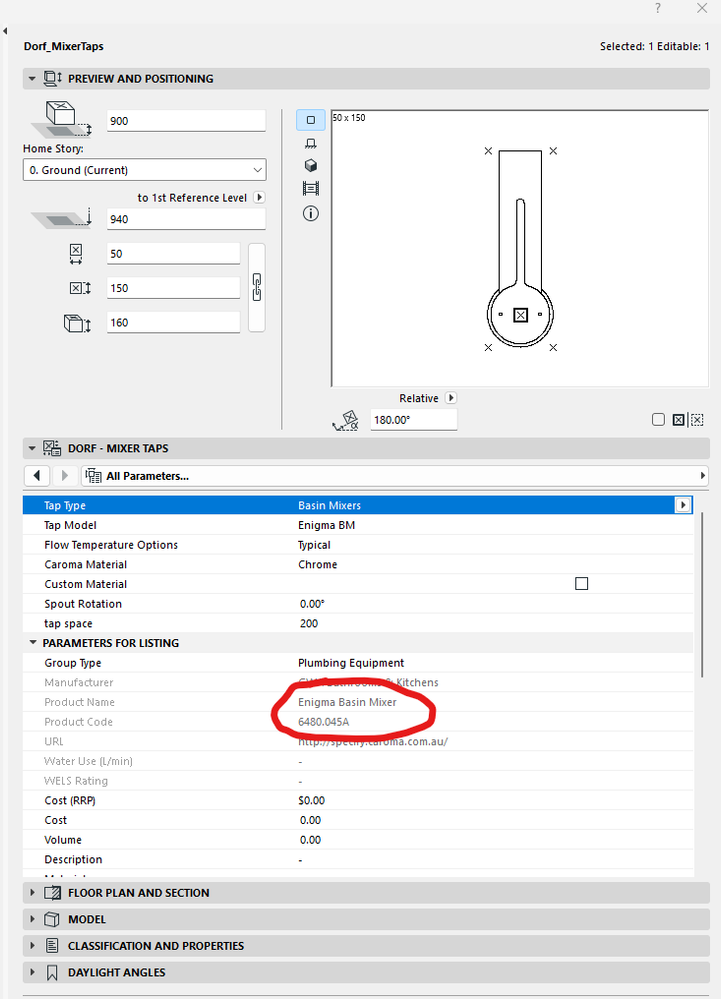

is it possible to edit the parameters of a label to be able to read any chosen parameter within an object?
For example - in the screenshot below, the mixer tap has a 'product code' parameter which I would like to be able to label on drawings.
I have inspected the parameters of the 'Classifications & Properties Label' but need direction on how to amend the script to display the parameters of the object in screenshot 1.

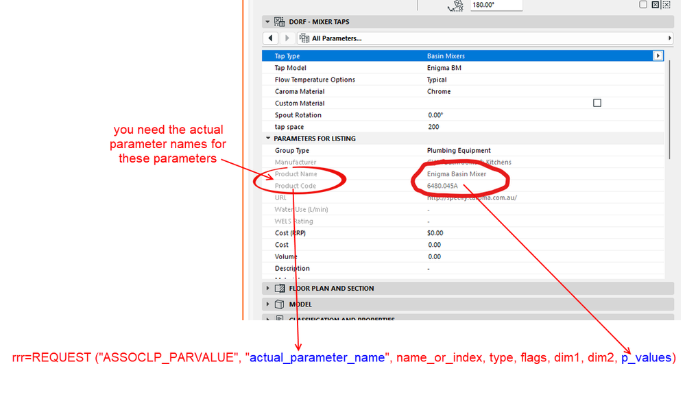

It can be done but you really need to know a bit of GDL scripting to control how you want the label to look.
In the 2D script of the label, you will need the following command....
rrr=REQUEST ("ASSOCLP_PARVALUE", "actual_parameter_name", name_or_index, type, flags, dim1, dim2, p_values)
"actual_parameter_name" is the actual name (in quotes) of the parameter for what you want to get the value of.
You will need to open the tap object to find that parameter name.
The command will place the value in the 'p_values' argument.
So you will then need to manipulate the 2D script to output text for the 'p_values' (without quotes)
You will need to do the same for your second parameter but the argument will be 'p_values_2' (without the quotes) so it doesn't get mixed up with the first p_values argument.
But you will need to be able to script the label to show the output as you want it.
Something I don't have time to explain just at the moment.
And I should say that this will not work with any other library object, unless they have exactly the same parameters you are looking for.
It is a shame that the auto-text label can not access object parameters.
It can access object properties, but object properties can not access object parameters either.
So you could label a property, but you would have to manually change the value of the property in the object.

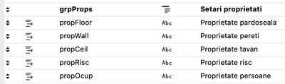

Here is how i achieved this:
1. For each property i needed to label, i set up a string based parameter that holds the UUID of that property
2. Set up a property holding dict in the master script
dict propertyData
_actProperty = ""
dim _sLocalization[]
	_sLocalization[1] = "<" + `ID` + ">"
	_sLocalization[2] = "<" + `Custom Name` + ">"
	_sLocalization[3] = "<" + `Name` + ">"
	_sLocalization[4] = "<" + `None` + ">"
	_sLocalization[5] = "<" + `Hotlink ID` + ">"
	_sLocalization[6] = `Custom`
	_sLocalization[7] = "<" + `Custom Text` + ">"
	_sLocalization[8] = "<" + `no content defined` + ">"
	_sLocalization[9] = "---"
3. Prepare the UI for the new settings
TABID_ROOT				= -1
_idxTab = 1
dim stTabTitles[1]
	stTabTitles[1] = `Content`
ui_current_page 0
itemID = 10
xEnd	= 444
yEnd	= 266
UIGroup = 1
dict propertyRequestIn, propertyRequestOut
n = request ("Property_Tree_Of_Parent", propertyRequestIn, propertyRequestOut)
if n <= 0 then
	! Make sure these fields exist in the DICT
	dim emptyArray[]
	propertyRequestOut.propertyTree = emptyArray
	propertyRequestOut.treeDepth = 3
endif
dim _propertyTreeItemForNone[]
for iCol = 1 to propertyRequestOut.treeDepth
	_propertyTreeItemForNone[iCol] = ""
next iCol
_propertyTreeItemForNone[propertyRequestOut.treeDepth + 1] = `None`
ui_listfield UIGroup, 0, 0, xEnd, yEnd, 0
ui_listitem itemID, UIGroup, "grpProps", 0, "", ""
4. For each property, set up a custom listitem
itemID = itemID + 1
r = REQUEST ("Property_Name", propFloor, _typeName, _groupName, _propertyName)
ui_custom_popup_listitem itemID, UIGroup, "propFloor", 	1, "" , "", 1, propertyRequestOut.treeDepth, 1, _propertyName,
				_propertyTreeItemForNone,
5. Now that property holds the UUID of the property you want to read. You can then easily use this to read it:
n = request ("Property_Value_Of_Parent", propFloor, type, dim1, dim2, fTxt)
My label here is a zone label and reads the finishes of floor, walls and ceiling, but you can generalize it. Saving it as a favorite or opt-picking it will retain the stored UUID so you can use same label to display different properties in the same text2 if you want.
