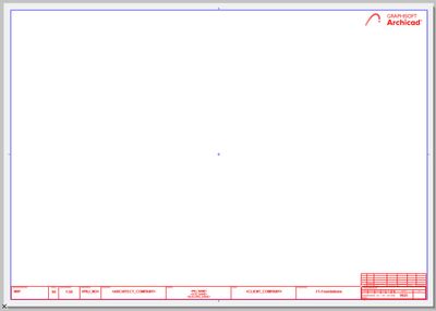

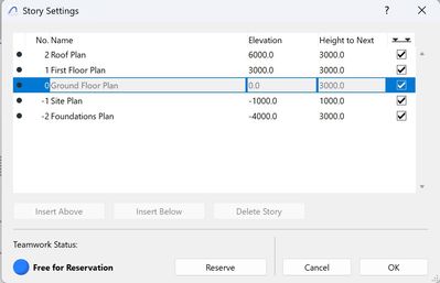

Essentially I want to add the stories table as below and yes add it to the layout sheet
 as a live viewport/table. I hope that makes more sense.

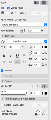

one thing I forgot to mention was, you may want to check the merge items box in the schedule style settings (screen shot and vid link attached, video may still be processing on youtube when posting this):
https://youtu.be/2mUbLEuOj8s
