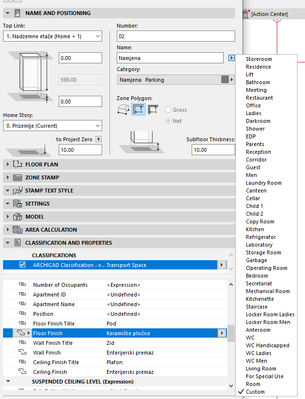

is there a possibility to change the default name settings in zone tool?mija_0-1675846443394.png

You need to edit the GDL of the zone stamp.
If the name list is not in the zone stamp object, it could be in a 'Master_GDL' file that will be somewhere in your loaded library.

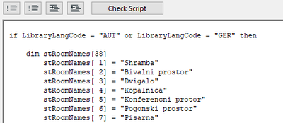

As @Barry Kelly said, you'll need to open a library GDL file. I am using a GER library on an INT version (to translate some items into my native language) and for me it was the "Zone_stamp_macro.gsm" file which had to be changed.

We have a Global Zone Stamp that was created by Applecore Designs which has a separate XML file that can be edited for the standard list of Room Names, I believe there was also a separate object that the stamp linked to where you could edit the list, maybe this is the same for the built in Zone Stamp?

mija
I've found it in parameters but I can't find where i can change all the option names. Every other tab is empty? 😩

You have to find the macro. The script is in the macro as previously stated

mija
found it. thank you guys
