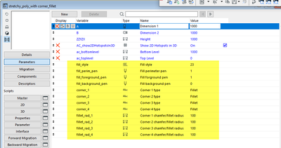

OK, here is my quick attempt at a 4 sided polygon that can have plain, chamfered or filleted corners.
I have only done a rectangular polygon based on the A & B sizes (width & height), and I have used PUT and GET to allow for the various nodes required for the different corner types.
First you need these parameters.
Then in the Parameter script ...
VALUES "corner_1" "None", "Chamfer", "Fillet"
VALUES "corner_2" "None", "Chamfer", "Fillet"
VALUES "corner_3" "None", "Chamfer", "Fillet"
VALUES "corner_4" "None", "Chamfer", "Fillet"

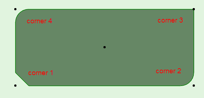

PEN fill_perim_pen
FILL fill_style
poly2_B nsp/3,1*1 + 2*1 + 4*1 + 8*0 + 32*0 + 64*0,fill_foreground_pen,fill_background_pen,
get(nsp)
That will give you a rectangular polygon that stretches by the corner hotspots.
And the corners can be set to either none,chamfer or fillet.
To have truly stretchy corner nodes (can be stretched in any direction) is quite easy.
You just need parameters for the x & y coordinates of the corners and if you want add stretchy hotspots for them.
The trick then is doing the calculations to work out where the coordinates are for the extra nodes needed for the chamfer and fillets.
Someone smarter than me will have to work that one out.
For each corner you will need to take into consideration the position of the two adjacent corners, as that will affect the edge line angles which will affect where the extra nodes are for the chamfer and fillet corners.
But this is a good example of how the PUT/GET part works.
JGoode
Hi Barry,
This is much further than I would have got on my own! Thank you very much. I'm having a bit of an issue with the fillet on corner 1. I had issues with the chamfer on corner 1 which I resolved but the lines are not connecting correctly after the curve. The line which should go from corner 1 to corner 2... goes to corner 4 and visa versa.
Any ideas why or how to fix?
Edit: Problem solved, had to figure it out and shuffle some values around. Thanks again for your time and help!

Sorry, it looks like I missed copying the script for the first corner.
I will fix that up.
You have to be very methodical and make sure all your nodes are in the correct order.
That is why I often use PUT for every node.
So I can simply reorder then by dragging the script lines around.
When you have multiple PUTS, you can group them together with one PUT statement and a comma after at the end (so it is basically a continuation to the next line), and no comma at the very end of the last line.
