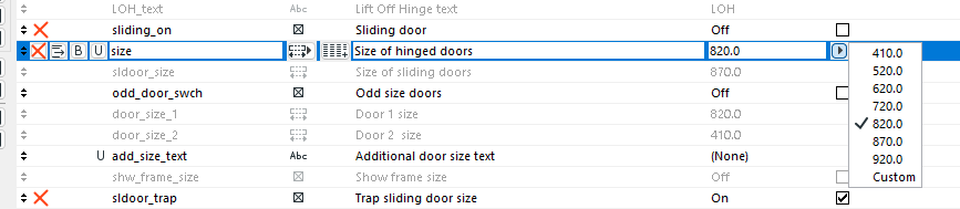

This isn't working for me
Values (sw) set:
but drop-down not functional
yesterday
oops, just realised I forgot to remove the "" in the values definition.
solved!
