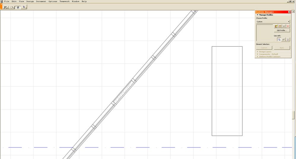

Creating a custom panel using slab(seen from front offcours). Giving it insulation material. Saving as curtainwall panel. As plan shows the orientation of the cutfill always follows x y axis, If i rotate the cw the fill doesnt move. Any ideas?

I hadnt tried changing material fill orientation, sadly it did not help. Neither changing it before i create the custom curtain wall panel nor changing it after changed anything. As the screenshot shows you can see that a wall with same material will get the effect of changing these settings, but not the custom panel!

So, I checked in the GDL Reference Guide, and in 2014 when Archicad 18 was released, the Building Materials feature was not yet implemented in GDL, which is necessary since Curtain Wall Panels are GDL Objects.
Building Materials was implemented in Archicad 21, and if I open a Curtain Wall Panel currently, I can see that it is indeed using Building Materials.
So, I think the bigger problem here is that in GDL you can create section geometry with any shape. The "Fit to Skin" option is relevant only in Composite Structures where all skins have a constant thickness so the direction and size of the Cut Fill can be easily determined. So we would have to have a way of doing the same in GDL.
I guess it could be done because, in the Profile Manager, there is similar intelligence - if you select a Building Material with "Fit to Skin" Cut Fill, it will fit the Fill properly in constant-thickness components, and even if the component's shape in non-rectangular, it tries to fit the skin based on some kind of algorithm.
So I can imagine, in GDL, you could have a GDL command, which would define an origin, a 3D direction vector, and another 3D vector defining the width just for the purposes of Building Materials with "Fit to Skin" Cut Fill, so, the origin and the two 3D vectors would adequately define how large the Cut Fill should be and in which plane in 3D it should be generated. Or something like that. This way the feature could correctly work in GDL as well.
