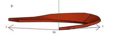

I was afraid of that. You were almost creating the perfect road tool for Archicad.
Roads need rotation along the axis to compensate centrifuge forces.
Yes. The Tube command needs this upgrade urgently.
Hmooslechner wrote:
Thougt also about rotating at the nodes, but its not possible with the normal tube-command. Maybe Graphisoft could add an extension for the tube with the possibilities of rotating the profiles on nodes in the future?
TUBE already has the ability to rotate the cross-section at each point on the path.
Here is a quick example...
TUBE 4, 18, 16+32,
-2.0, 0.0, 0,
0.0, 0.0, 0,
0.0, 0.4, 0,
-2.0, 0.4, 0,
-1, 0, 0, 0,
0, 0, 0, 5,
4, 0, 0.1, 10,
6, 0, 0.15, 15,
6+4*sin(15), 4 - 4*cos(15), 0.2, 20,
6+4*sin(30), 4 - 4*cos(30), 0.25, 25,
6+4*sin(45), 4 - 4*cos(45), 0.3, 30,
6+4*sin(60), 4 - 4*cos(60), 0.35, 35,
6+4*sin(75), 4 - 4*cos(75), 0.4, 40,
10, 4, 0.45, 45,
6+4*sin(105), 4 - 4*cos(105), 0.5, 40,
6+4*sin(120), 4 - 4*cos(120), 0.55, 35,
6+4*sin(135), 4 - 4*cos(135), 0.6, 30,
6+4*sin(150), 4 - 4*cos(150), 0.65, 25,
6+4*sin(165), 4 - 4*cos(165), 0.7, 15,
6, 8, 0.75, 10,
0, 8, 1, 5,
-1, 8, 1, 0

Hmooslechner
I dont know how i could miss this possibilities till now, but it seems to be a kind of ignorance..
May the 4th be with me - hope it doesnt take that long..
After some tries - It seems pretty simple, but for me it is hours of work already.
Whats to do:
2 possibilities:
to apply profile - rotations on each edge extra with editable hotspots
or
rotate profiles on each edge at once with one command at all.
Make it on each edge is a bit easier, because you don't have to proof on wich side is the smaller angle and the user has to apply it on each edge extra in 3D (maybe in 2D-projected sections? similar to the length- sectioning)
A step aside: in Austria, streets are build nearly without rotating the profiles to keep the driven speeds down...
They are rotated just to keep the water floating away but not for getting higher curve-speeds.
Normally, streets are constructed with clothoid for road curves and my bezier-solution is some kind of "nearby miss" already. So this logic of the bezier-curves could also be taken for raising-falling of the profile-rotation on the Edges.
