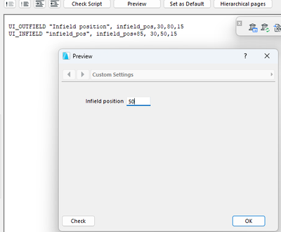

I wonder, is it possible to dynamically move the x,y, position of text in the interface tab? My goal is to dynamically offset text, within the interface panel, depending on a parameter of the script.
My example would be to create a variable in the Parameters Tab called x_offset = 10mm
In the Interface tab I would add the code:
ui_outfield "Note", x_offset, 0, 120, 14
However it doesn't seem to work and defaults the position value to 0. Any help would be most welcome! Best to all.
1 ACCEPTED SOLUTION
Solution

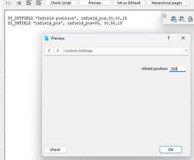

Sure you can.
Make your parameter a 'integer' because the interface is pixels, not distance.
Then the script.
UI_OUTFIELD "Infield position", infield_pos,30,80,15
UI_INFIELD "infield_pos", infield_pos+85, 30,50,15
And the result.
Have fun chasing it around the interface.

That works beautifully with an integer, I never would have discovered that myself, thank you Barry you are a genius, quite exciting!
From the above, is possible to use the value from a dimension variable (x_offset) to drive the integer variable (infield_pos)?
My thinking would be in the Master Script to add something like:
infield_pos = INT(x_offset)
Parameter x_offset = infield_pos
But maybe it is not possible to use a value in mm to set an integer value in pixels, it would be great if it was though. Best to all.
GDL Enthusiast
Found solution to the above of converting the dimension from mm. It works, thank you again Barry, so so helpful!

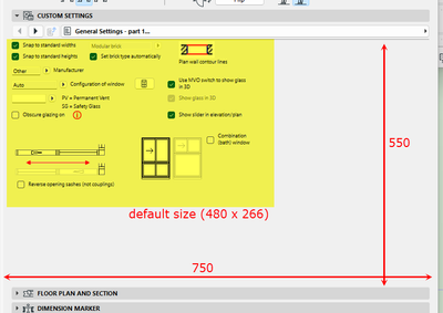

@MF BIM ,
That is just the default minimum size.
You can set a custom dialogue much larger if you want to.
Here I have just increased one of my window interfaces.
UI_DIALOG `CUSTOM SETTINGS`, 750,550
So there is much more space to be had if you need it.
I probably wouldn't go too big though.
