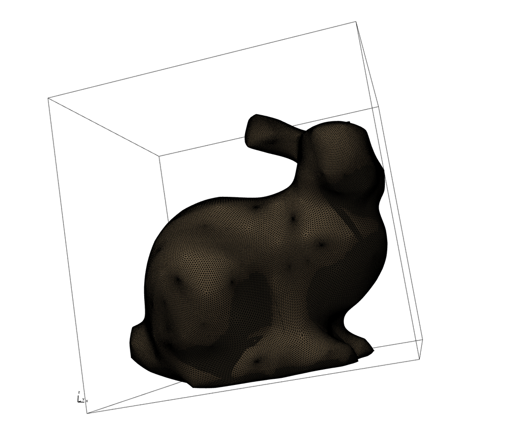

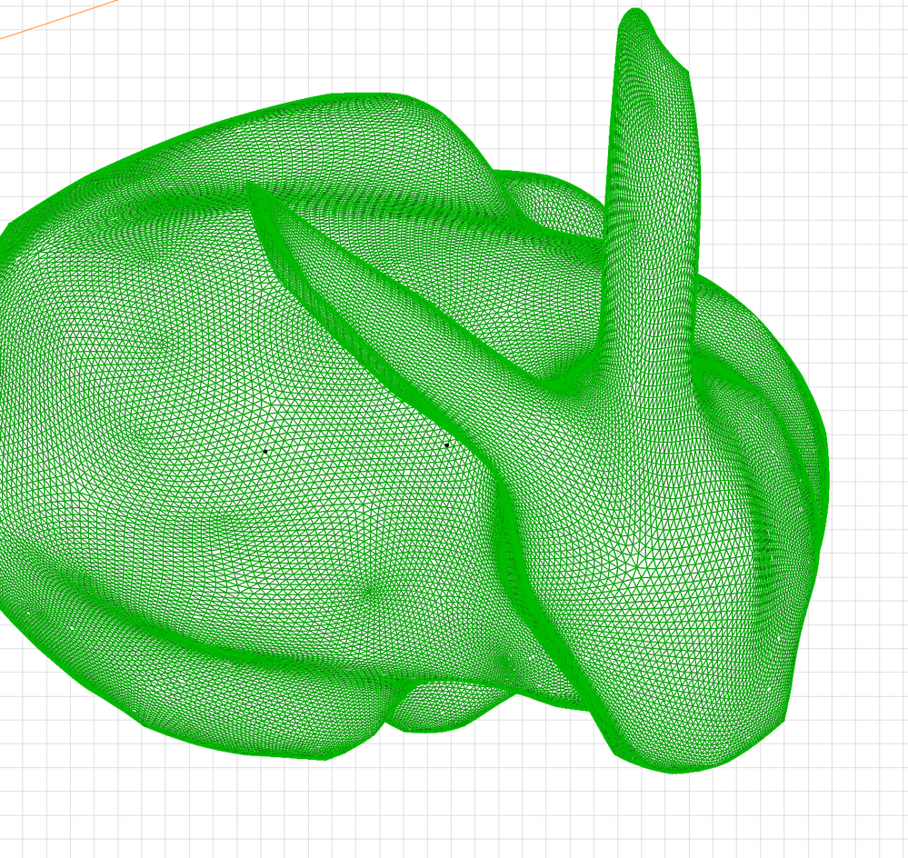

Low poly bunny with 4 loop subdivision iterations.
124000 triangles.
Does not use PROJECT2
Working on a projection routine that is optimized for larger meshes, already a big speed improvement.
