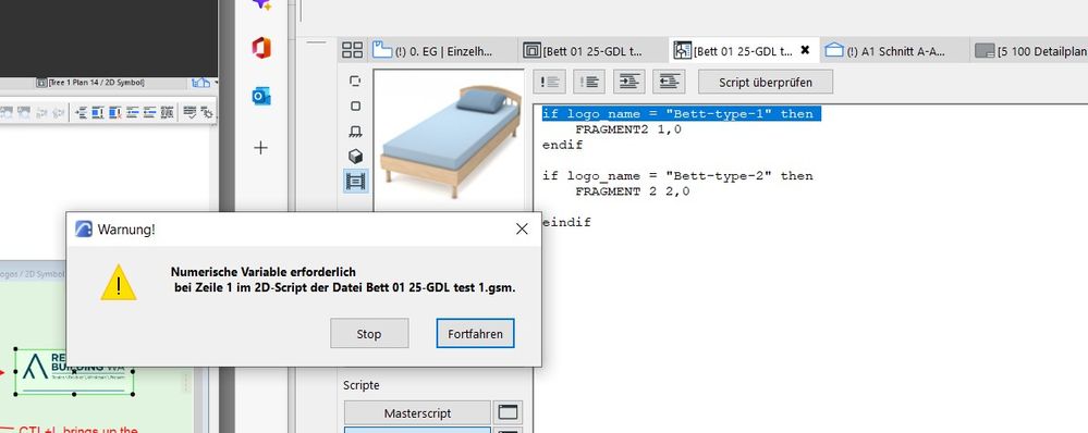

2022-12-20 05:18 PM - edited 2022-12-20 05:21 PM
Hi Barry,
Thank you. but I actually still get the same error. I get a positive message when I check the script but an error, when i save the object.
I think it wouldn´t hurt if I check the manual about GDL coding myself a bit 🙂
2022-12-21 03:54 AM - edited 2022-12-21 03:55 AM
It looks like you have spelt ENDIF incorrectly.
