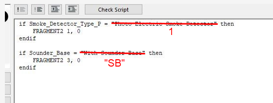

You are using the parameters incorrectly.
You need to be checking for the value of the parameter.
For a boolean it is 1 or 0 (on or off).
For a text parameter you need to be using the value typed into that text parameter - in tour case "SB"

That's great, thank you for that.

For the boolean, you do not actually have to put the value, you can just write "IF [parameter] then". Using this same notation, you can utilise it within sums, usually to decide whether or not to add a value.
