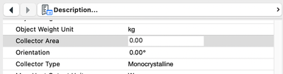

I would also expect to see a functioning area parameter that allows us to calculate the output in a schedule.
There is one there:
but it has no data.

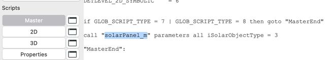

Interesting.  Like so many bits in the libraries, the Solar Voltaic Panel has all of the work done in a macro that is called from the Master Script:
If you highlight the name of the macro as I did, and then press cmd-opt-O it will open the macro in a tab and you can see all of the scripts for the solarPanel_m macro.  The parameter iSolarObjectType has 3 potential values... where "3" is the photovoltaic panel.  Not surprisingly - like most of the primitive and ugly code from Graphisoft - there are no comments within the scripts to tell you what is what, so you have to sort it out yourself...e.g., if iSolarObjectType = 1 then... like how hard was it for the coder to put in a comment to say what a type 1 is?  Etc.
Edit:  Trial and error placing and opening objects: Solar Collector Flat Plate is type 1; Solar Collector Evacuated Tube is type 2.

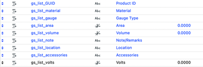

The object contains the following parameters:
They are in the Parameter window and look like this:

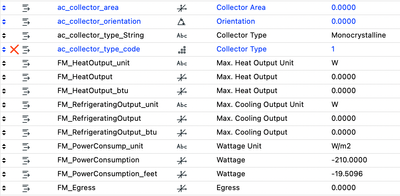

I added a line in the Master script pane that looks like this:
ac_collector_area = (panelWidth*panelHeight) * (nPanelHorizontal*nPanelVertical)
Then I opened the macro and entered the line in the Master script pane for that too.
But it didn't work with either option. The Collector Area field is blank. I'm obviously doing something wrong, I just don't know what.

Peter Baksa
The parameters on the description page are a general set of parameters for all mechanical objects. FM_PowerConsumption with description "Wattage" has a negative default value which can be interpreted as output.
If you are going to modify the object, the ac_collector_area calculation can be done in the object too, it doesn't have to be in the macro. You need the parameters command to store the calculated value. Library parameters can be summed in IES.
If you are solving this with properties, look at property expressions. These can do basic calculations with other properties and element settings. They also access object width and length, but no other GDL parameters.
