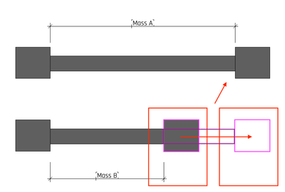

Hi there, in the GDL editor script (2d and 3D), what must be the script, to edit a flexible dimension between "Mass A" and "Mass B"? (example form 20 to 50 possible)
and 2nd)
I want to know more about edit. flexible hotspot2 and hotspot.
I saw the script in some gdl ex. files, on Graphisoft GDL homepage etc.,
but I still don't understand this to program .... (Graph. edit. Hotspots)

Hi there,
I saw some videos and tutorials, but I don't check this.... :-(.
Base, Reference, Moving etc....
Can make anybody an example for this:
 To move the square with the bar (square hatching)........
> What must I do in parameters
>What must I do in 2D-Script......  > WITH EDIT. HOTSPOT2
Always when I test, i have red dots, and they move alone, and in some directions, without the square and hatching with bar......

Please post your script. I'll try to help debug it.
