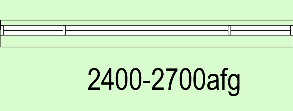

Hi guys,
I've started making my way through learning GDL, using the Reference guides, and mostly via modifying existing scripts and checking various outcomes.
Current project is to restructure the 2D Dimension display of the Archicad 24 gs_dw_Marker
Specifically the Dimension Style = DIMSTYLE_1LINE
My query is how is the structure of the code dictates String Text before the Length Values : Ref Image Below
By replacing & switching the _lengthHeightValue with the _lengthWidthValue i can control the values, but how is the flow control statements, structuring the position order of the string text before the Length Values.
I understand its my lack of basic script knowledge, but i struggle to learn without direct application, so reading the reference guide is only helpful to an extent.
Refer to the Script Below, I've listed my values to be replaced in red, with there substitutes in pink.

1 Solution
Samuel1997
Hey guys, so, i just finished my workaround for the issue.
I created a copy of the : gosub "Print text considering readability"
Saved as : "Print text considering readability2"
Then just Modified the go sub referenced in the Width & Height script to match the new one, then changed the "Print text considering readability2" Script as per Palawats idea in cancelling out the remainder of the paragraph and adding the required code into the note1 Line!
This way the other data inputs / Show Parapet / Show  Location / Ect. can still refer and use the original "Print Text Ect" Plotting Script.
Ive attached below the finished 2D Script Below for record:

else ! iDimensionStyle = DIMSTYLE_1LINE
del 1
_nTrans = _nTrans - 1
! --- Dimensions with separator ---
_iUnitTypeByContent = 7 ! "Windor_Door_Dimension"
if AC_WidHei_On then
_formattedHeight = ""
_formattedWidth = ""
_formattedHExtra = ""
_formattedWExtra = ""
_horAlign = 3
_TextFont = _textFont2
_TextSize = _textSize2
_TextStyle = _textStyle2
_szPrefix = ""
if GS_iCustomText_2 = CTXT_CUSTOMTEXT then
_formattedHeight = stWidHeiPrefix + AC_MarkerText_2
else
_lengthValue = _lengthWidthValue
gosub "call_quantity_formatter"
! store returned formatted text
_formattedWidth = note1
_formattedWExtra = note2
endif
if GS_iCustomText_3 = CTXT_CUSTOMTEXT then
_formattedWidth = stWidHeiSep + AC_MarkerText_3
else
_lengthValue = _lengthHeightValue
_formattedHeight = note1
_formattedHExtra = note2
endif
note1 = _formattedHeight
note2 = _formattedHExtra
note3 = _formattedWidth
note4 = _formattedWExtra
style1 = "mtext2style"
style2 = "extraStyle2"
style3 = "mtext2style"
style4 = "extraStyle2"
notesize = _textSize2 !+_textSize2/3
angle = textAngleWH
enabled = AC_Readable
iMarkerDir = iDimensionsDir
if _formattedHExtra <> "" or _formattedWExtra <> "" then
_increaseTextSize = 1
else
_increaseTextSize = -1
endif
posY = whDistModel / PAPER_TO_MODEL
if (angle > (gs_readable_angle + eps) & angle < (gs_readable_angle + 180 + eps) & enabled & iMarkerDir = DIRVALUES_PERPEND) | \
(angle > (gs_readable_angle - 90 + eps) & angle < (gs_readable_angle + 180 - 90 + eps) & enabled & iMarkerDir = DIRVALUES_ALIGNED) then
posX = stw (_formattedWidth) + stw (_formattedWExtra)*2/3*_increaseTextSize + stw (stWidHeiSep) / 2
else
posX = stw (_formattedHeight) + (stw (_formattedHExtra))*2/3*_increaseTextSize - stw (stWidHeiSep) / 2
endif
if iMarkerDir = DIRVALUES_ALIGNED then
add2 -notesize/3*PAPER_TO_MODEL, 0
endif
_bWidHei = 1
_textPen = _textPen2
gosub "Print_text_considering_readability2"
del 1
endif
endif
endif

Samuel1997
Hi Lingwisyer, thanks for the reply!
I've copied the code in below, i was under the impression that the plotting script would have to reference the (_LengthHeightValue & _stWidHeiPrefix, ect. )? but i guess this isnt the case, still unsure as how to the data is being transfered.
! Print text considering readability

Samuel1997
The goal is to restructure the stWidHeiPrefix to show at the end (as a suffix)

Samuel1997
Hey guys, Thankyou for the responses!!
So i worked out that the note1 & note2 were obviously the sizes, but were combining the Prefix & Separator into each, back in the 2D Dimension text script that i originally posted. The note 3 & note4 seem to be variations of note 1 & note2, so restructuring the code with those notes wasnt ever going to achieve the intended purpose!
I solved it via removing the prefix & separator data that was being added into note1 & note2 in first section of script originally posted, then I Followed up with Palawats idea in cancelling out the remainder of the paragraph and adding the required code into the note1 Line!
  • paragraph "Paragraph1" 1, 0, 0, 0, 1, 0 !1
    pen _textPen
    style _textStyle1
    note1 + stWidHeiSep + note3 + stWidHeiPrefix

And this was the Outcome!
So far seems to be working, just have to double check & stress test that cancelling the note3/note4 doesnt create issues!
Thanks for the help guys! Very Informative, and your effort is appreciated!
Kind Regards Samuel H

Samuel1997
Honestly its quite the labyrinth!
And that definitely is an issue, as now that those parameters have been added directly into that paragraph controlling the text plotting, all other additional parameters which had options to be added in with their own textblocks and hotspots, are now also combined with the prefix & separator from the dimensions code.
So for instance if the fire rating textblock is activated, it produces as follows:
To combat this i know i'll have to restructure the original note# within the window height & width script individually, rather then the paragraph controlling all of the text blocks. But i still count this as a minor win in learning the behavior of the paragraph in relation to the text block.
I have my goal for the weekend and at least a place to start!
