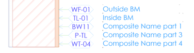

Fixed mine. Can display the building material, surface, composite or complex profile for most building elements. For building materials, it displays the building material ID of the chosen outside face. For the rest, it splits out the part of the attribute name set by a delimiter. For composites, this allows you to put something like a core code in one part of the name and a unique code in another.

Great object. This should be rolled into the stock label.
I couldn't get the “Building Material” option to work on walls.
I made a different label for this purpose a while ago, the code is probably a mess and it only works on walls. Feel free to nick anything that looks useful.
Thanks for sharing your efforts.
2 weeks ago - last edited 2 weeks ago
The Building Material option just pulls the Building Material ID rather than the name like the other options. Could give it the option to use the name I guess if you want to store other information there... Was it returned an error for you, or just returning nul?
ps. Oh, the BM option does not work on basic walls... Woops. Assume it is when ever it is a basic element since the SKINS_PARAMS variables do not work with them. I think I have fixed it now.
