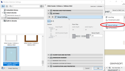

I'd like to hide the "Reveal Settings" tabpage, which is listed under "Settings"
I created a custom Window with my own tabpages, but the tabpage "Reveal Settings" automatically shows.

With ac_wido_hide_options  (=3)
https://gdl.graphisoft.com/reference-guide/parameters-read-by-Archicad

I don't think you can.
Reveals are a part of every door and window.

Awsome, thanks @Yves .
I am still learning after all these years.
Pays to read those manuals from cover to cover. 😉
@Martin Walter , I''l leave it up to you to mark the post as solved if it does what you want.
