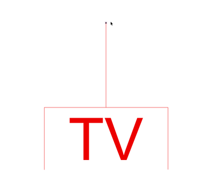

Hello everyone,
Does someone know if there is a way to change the default selection point on a libray part?
I created a custom library part with a 2D Symbol and I added a hotspot in the position where I want to "grab" the object:
Now, when I select the object from the library I always have to switch from the default handle (bottom left) to  the handle I created (top middle).
Is there a way to define my handle as the default?
[Archicad 24 6004 GER FULL]

Tested it out because I wanted to now the truth.
What I found out:
The insertion hotspot will be at the lower left corner of the bounding box of the object, if you don't script your own hotspots, or do use the "Fixed Hotspots" option in the compatibility options.
If this option is not used and you script your own hotspots, then the first one which is scripted logically will be the insertion hotspot.
Logically here means, that the script order is observed, and not the position in the script. You can test and verify this with a subroutine.
What I found out:
MichaelaR
unticking the "fixed hotspots" solved the problem, thank you!
