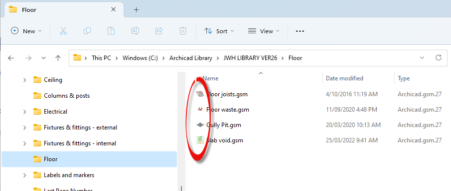

How do I display thumbnails of the GSM files generated by GDL on my computer?
baixiaodong
Previously, it was possible to display thumbnail images of game files on laptops, but now it's not working. I don't know where the problem is, please help me out

Solution
Try this.
In the Program folder for Archicad you will find a folder called "GRAPHISOFT Shell Extension".
In there is a file called "Register.bat".
Double click it to run it.
You may need to restart your machine to see any change.
It should work.
