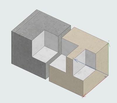

I can't find a solution to inherit the material from the "base group" in GDL.
The code I made, always attribuites to the cut polygons the material of the "tool group"
I'd like to have the cubes inherit their own material
PEN 1

Hello @Mario Sacco ,
You need to input the materialId value in the 4th argument of the subgroup command. If you want each block to have its own material then you would need to have as many base groups and subgroup commands.

Mario Sacco
This solution is ok if I can separate the single objects.
My code include hundreds of objects with different colours and I need execute the subtraction only one.
As you can see the are many panels and the side cutted volumes have an incorrect surface.
I probably will try to use CUTPOLY for my problem, but for complex operation it can't work.
