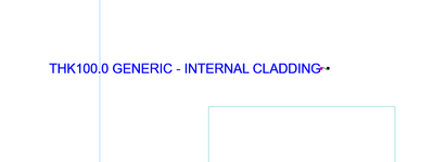

soo
I'd like to sum the thickness of the two complexes into one
I'm developing a skin label.
and feel little bit difficult to sum the thicknesses of the two complexes into one.
I mean if they are same type of complex, make sum the thickness together.
for example, I wanna get the label display "THK 200.0 GENERIC - INTERNAL CLADDING".
I put this in 2D script. and then I got 2 error messages .
how can I solve this problem? I'm happy to someone reply that.

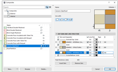

runxel
Now there is something to know about Archicad composite walls:
You can't have "two" or more cores (That's why setting the reference line according to the core works), but you can have none at all. Skins set to "core" (in opposition to "finish" and "other") must be adjacent.
Also be reminded that the global "WALL_SKINS_PARAMS" will list the skins from outside to inside.
The last "core" skin (if one is defined as such) will have the core status set to "3", the other ones will be "1". You can't differentiate between "finish" and "other" as far as I can see.
I am not sure why you would need to add those claddings, I probably would have found it more interesting to see "outer skins thicknes – core thickness – inner skins thickness", but what you want is really easy to achieve.
You have to explicitely check the bounds of an array. For us this number lives already in the WALL_SKINS_NUMBER global.
Also, because a wall could have up to 127 skins, you should do your calculations in a loop.
thk_non_core_skins = 0.0
for i=1 to WALL_SKINS_NUMBER
  if WALL_SKINS_PARAMS[i][6] = 0 then
    thk_non_core_skins = thk_non_core_skins + WALL_SKINS_PARAMS[i][2]
  endif
next i

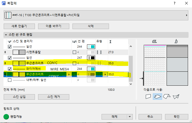

soo
sometimes I need to put wire mesh line between concrete at skin complex menu for cross section expression.
So in this picture, actually the concrete's thickness is 70mm.
but when I use a label object, that can express only 35mm.
that's why I wanna get sum 2 skin complex's thickness into 1.
and I wanna make them automatically.
 I put this one into <2D Script> but it's not working.
for n=1 to WALL_SKINS_NUMBER
if stFinish[n] = stFinish[n+1] then
thkFinish[n] = thkFinish[n] + thkFinish[n+1]
endif
next n
thanks for your reply.
Soo.
