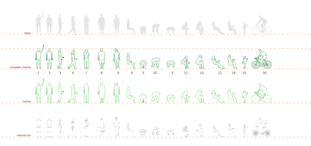

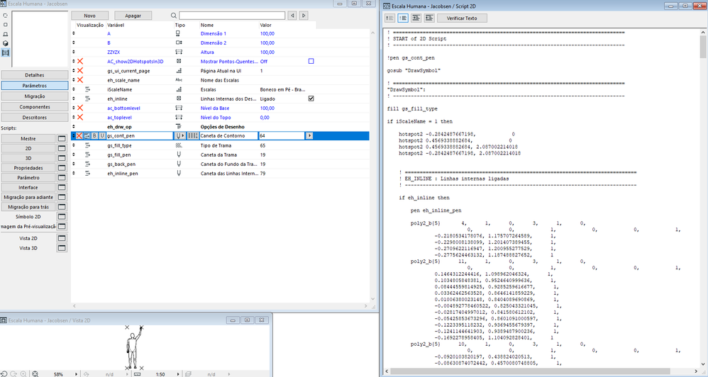

I'm making a object of some complex 2D symbols and i would like to be able to select the object by the lines wich are drawned, i know that we use the HOTLINE2 command to make this dream come true.
But my problem is that the drawing is to complex for me to just write the hotlines, or the POLY2_B myself, So i'm drawing what i need to show in 2D and saving it like an object to use the poly2_b auto scripted. But by that, i dont have a consistant way to write te hotlines.
Is there a way to do that easly?

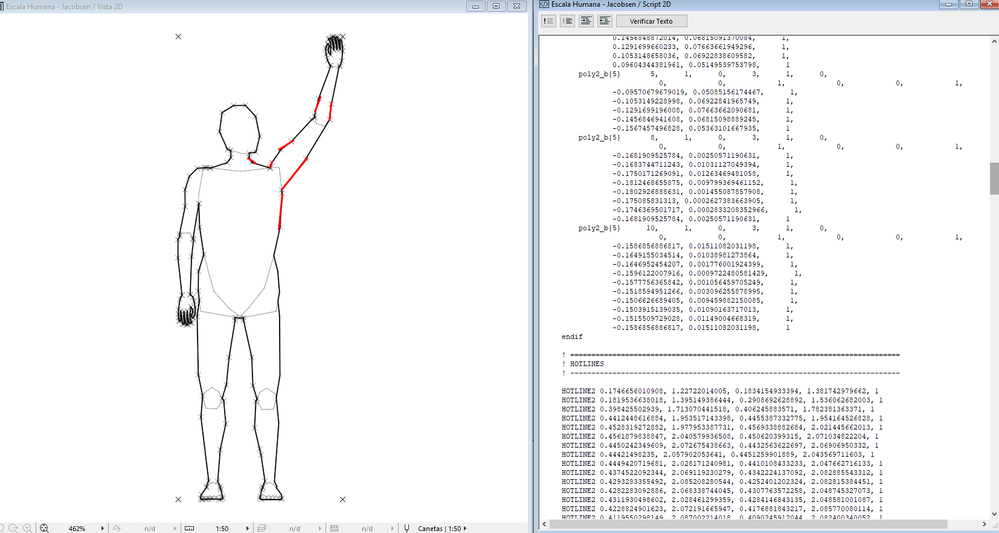

Cause i even tryied to make the chat gpt and gemini to translate the poly2_b cordinates to HOTLINES, it works almost perfectly, but it skips a line... like, the way that i taught GPT it writes a HOTLINE perfectly, but the next one that it writes is a line that is not connected. The request that i did for GPT is the following:

The drawings that i made, the first  row is the fill element, the second it's for me to see what i draw, the tird is the outline (witch i wanna use as hotlines) and the final row is the internal linesThe drawings that i made, the first row is the fill element, the second it's for me to see what i draw, the tird is the outline (witch i wanna use as hotlines) and the final row is the internal linesthe beggining of the 2D scriptthe beggining of the 2D scriptthe red line is an aproximation of the hotlines that are drawn and converted from the gpt scriptthe red line is an aproximation of the hotlines that are drawn and converted from the gpt script
