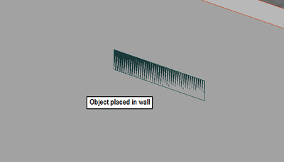

Hi all,
I am making sockets and switches in GDL and was wondering if an object can cut through a wall.
since I am making a socket/switch I don't want to use window/door as subtype...
Is there a way that I can tell a part to cut thou the wall?

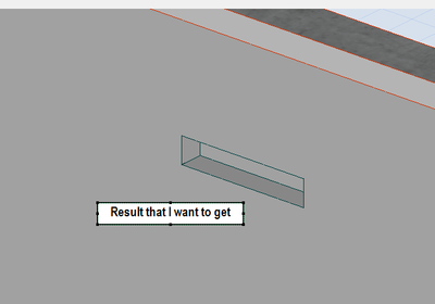

Domagoj Lukinic
Do you happen to know where I can find example object or something? I found an example here: https://gdl.graphisoft.com/gdl-basics/scale-sensitivity
but I don't quite understand the logic behind it... my goal is to see a wall that has a hole with t thickness in 3D

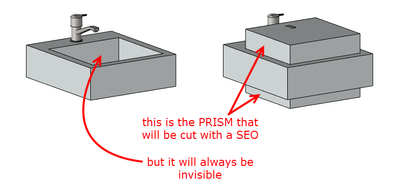

Here is a bit of code I use to cut a hole for a square shaped basin.
!GLOB_CONTEXT = 44
!! use prism to cut bowls when used in Solid Element Operation
if GLOB_CONTEXT > 40 and GLOB_CONTEXT < 50 then
	PRISM_ 5, b_hgt+top_thk,
		 half_b_wid-side_inset,  -half_b_dep+fr_inset, 15,
		-half_b_wid+side_inset,  -half_b_dep+fr_inset, 15,
		-half_b_wid+side_inset, half_b_dep-rear_inset, 15,
		 half_b_wid-side_inset, half_b_dep-rear_inset, 15,
		 half_b_wid-side_inset,  -half_b_dep+fr_inset, -1
endif
You can use any PRISM, BLOCK, CYLINDER, or whatever 3D shape you want.
Just make sure it is the correct size and in the correct position.
Uncomment the line ... !GLOB_CONTEXT = 44 ... and you will see the shape to be cut in relation to your object in the 3D preview.
Domagoj Lukinic
Thank you for your replay, but i need object to cut a physical wall outside of my GDL part.
I am making distribution cabinet that has 3 options: built-in, on wall, and self standing.
when you select a built-in version and MVO=RCP the placed object needs to make a hole in the wall (or on what ever surface it touches) from model geometry
Just make sure the cutting body is in the position of the volume that you want to cut.
