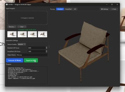

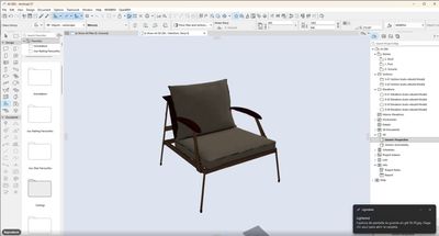

marcoariveross
I don't know if it's real, but this is in development:
https://www.linkedin.com/posts/v-k-t-r-s_image-ai-archicad-activity-7430433772849987585-9XPT/?utm_so...

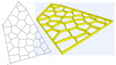

Hmooslechner
Maybe  - have a look at this german task in this forum. I made some Polygon-Fill GDLs with circles und a kind of Voroni-structure even in 3D with the help of DeepSeek AI and Gemini 3.1 AI:
https://community.graphisoft.com/t5/Programmierung/2D-GDL-Kreise-verteilen/m-p/693573#M8325
this is Esteban Ramos dynamic polygone-Code - filled with this structures.
If someone wants to try it: AC29EduAut: https://www.dropbox.com/scl/fi/hpw91huipdudxo3fiw7p0/Kreise-verteilen.pln?rlkey=jdrfq2l2sjqr3tnnvxxv...
