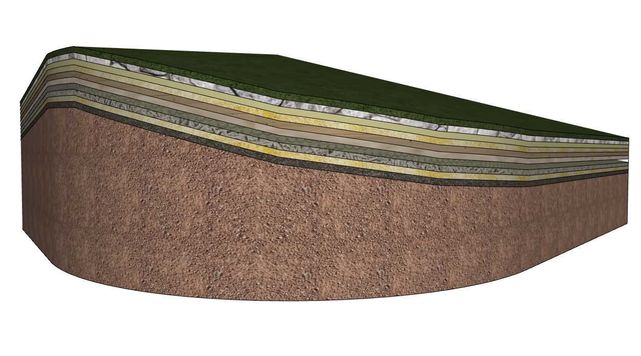

Hello.
As in the topic, I wanted to ask you guys if there exists any tool that would allow me to create a mesh with a specified thickness, or layers.
For example, I have a terrain to model, but the ground has layers: 3cm of grass, 10cm of ground, and some other layers. The terrain is not flat - it has some holes and bumps. Is it possible to create this with one tool/object, not using layered slabs, roofs, and shells?

I wouldn't call them bugs, but there are a few quirks with easy workarounds:
[list=]
  • Mesh type needs to be solid. Using "with skirt" or "surface only" doesn't give the desired results.
  • [list=]
  • If there is no top surface override for the original mesh, the final composite ignores the surface setting and displays the material properties instead. That's because the parameter (materialAttribute_1) isn't created when you save the mesh as an object.
  • [list=]
  • The same is the case for the bottom surface.
  • [list=]
  • However, if you override the sides of the mesh, the final composite will display that override on the sides (in 3D), no matter what settings you use.
  • Hope this helps.
    EDIT: This is for version-1
    = v i s t a s p =
    bT Square Peg
    https://www.btsquarepeg.com
    I will put a note for this in the instructions.
    The intended behavior was that if there is no top surface override (Mesh Model Setting) then it will assume the BM surface. Also I don't see any need to override the Side/Bottom surface of the original Mesh as they usually are related to the BMSurface. Do you think it is needed?
    I will also describe the workflow on the 2d text empty object:
    1. Create the desired Mesh shape with solid construction method and correspondent Building Material;
    2. Override the top Surface (on the Mesh Dialog Setting/Model) to the Surface of the first skin;
    3. Set the 2d view settings to "Cover Fill" and "Use Fill from Surface";
    4. Set the Fill origin as needed;
    5. Place a hotspot on a Mesh node to better place the Object in 2d view;
    6. Select both the Mesh and the hotspot and save it as an Object inside the Library (External or Embedded);
    7. Reload and Apply the Library every time you save or resave the original Mesh.
    What do you think?

    vistasp wrote:
    I can't think of a use for it. Yet. 😉
    You never know, though, what someone might use the object for, and the functionality is already built-in, so all good.
    Thanks for the feedback vistasp.
    I did some changes to better control custom surfaces, increased the number of skins to 10 (Just in case ), and improved the 2d instructions.

    Braza,
    Great and useful object.
    Would it be possible to script 3D hotspots to useful points of the generated object, like nodes of the top surface? This could be useful when trying to position it vertically.

    This is a great addition and pretty straightforward to use. One suggestion for improvement could be that the hotspots added to the object are placed on the top of the mesh in 3D, this would help greatly in properly aligning the element in 3D.

    Thanks everybody for the feedback!
    I did some tweaks to address some of your points. The updated version is attached.
    @ LaszloNagy
    Unfortunately it is not possible to have the original mesh hotspots on the object. I tried to solve this creating a parameter where the user insert the original mesh skirt height. But this approach could create some inconsistency for some unusual mesh node heights. So I decided to eliminate the skirt height parameter and use the base of the mesh as the reference level to match the object with the original mesh. What do you think?
