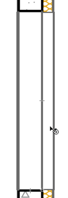

Is there a way to control WALLHOLE, WALLINCHE lines in section? said not to appear
I use WALLHOLE 1 , WALLINCHE 1 .
It seems that there are a lot of section lines, so it is good that only the two outer lines appear.

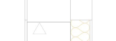

If You set a switch to unify all surfaces on cut (by material statement prior to wallhole or wallniche with status "2") preferably only for sections then it would do the trick.
