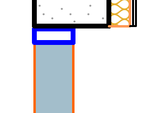

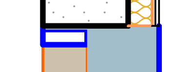

After the wallhole, the frame is odd in section.
It's the same cross section.
However, it is expressed differently. (It feels blocked by something.)
And this happens even if status is set to 1.
What's the matter?

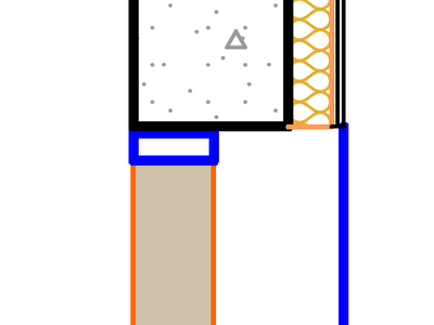

However, if you cut only the frame, it is normal as shown below.
material "air"
AC27 on window 11

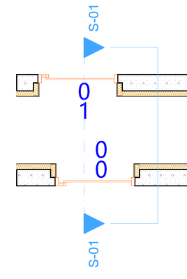

this is plan view
The difference between the two walls is wall flip.
What should I do?
AC27 on window 11

But what I want to ask is that the door is installed on the same wall, but only on the other wall, toward the structure. This is a question about how to solve the phenomenon that half of the frame line is covered by the wall fill.
If you look closely, after using the wallhole, the phenomenon that half of the frame made with prism_ is covered by the wallhole fill only occurs on the left side.
I was asking how to solve this.
The source code is studying the door dimension example ac19.gsm file.
AC27 on window 11
LeeJaeYoung
I don't know what went wrong either.
The solution is to delete the section and create a new section.
The phenomenon that the door frame on the right side overlaps the fill of the wallhole has disappeared.
I think the cross section is a bug in my judgment.
thank you so much
