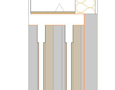

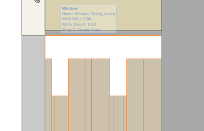

Different materials in the cross section, but why are they being merged?
This is the window I made.
Why does this phenomenon appear in cross section?
The material is the state designated as gs_sash_mat and gs_glass_mat, respectively.
2-sash Sliding Window 26
GS door: glass fill - Graphisoft Community
In this case, prism_ status code is set to 5.
So how should the frame and sash be treated?
AC27 on window 11
1 Solution

In section body with same fill merged. You need set different fills in code, with sect_fill

or...make a gap between elements.

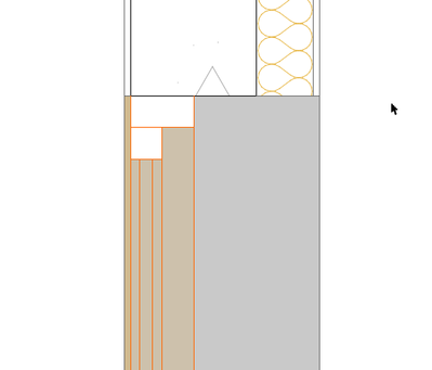

LeeJaeYoung
But what about in standard windows?

LeeJaeYoung
I thought it would be possible to use a different section fill for the surface, but I found out that wasn't possible.
Other surfaces have also been merged.
So, I decided that I had to use sect_fill.

The default frame cut fill is "Background", sash cut fill is "Air space". They look the same, but are different attributes, so they don't merge.

thank you I understand that the section material should be different, and I decided to create and use BG_Frame1,2 and BG_Sash.
