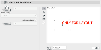

I'm making an object that acts like a stamp. It's our alternative way to using acrobat's pdf stamps. Anyways I've come across an issue where I can preview the object in the object setting since it only works in layout/publisher.
In the screenshot it only shows what it will look like when the user places the object in 2D plan. The actual object only appears in layout. How do I make the 2D preview show layout instead?
The object shows up when the user places it then opens object settings.  
1 ACCEPTED SOLUTION
Solution
That is because it does not do what it needs to do until you place it on a layout.
Until then it has no idea what it needs to display.
The best you can do is take a screen image of what it look s like when on a layout, and paste that into the 'Picture Preview' window in the GDL editor.
Then the preview image of the object will at least show what it will look like.

If your object has various ways to display, it might sometimes be a good idea to make an image that shows those variations.
Thanks barry,
I was hoping to avoid the picture preview and somehow point 2d preview to layout instead.
I think this has forced my hand
runxel
Hero
There is a very easy solution. Since you already test for GLOB_VIEW_TYPE (= 8 == Layout), just amend that IF loop with GLOB_PREVIEW_MODE = 1.
Then you'll see the layout stuff in the preview.
