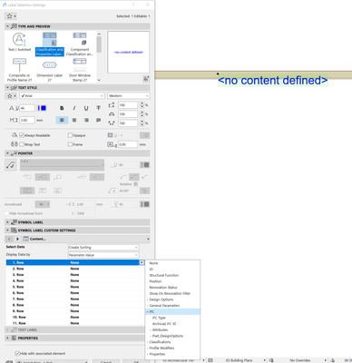

Label to show IFC Parameters
How can I create a label that shows IFC Parameters of the labeled element like the Archicad "Classification and Properties" label does?

kmitotk
”Classification and Properties" label works to display IFC properties as well. Unlike other element parameters IFC parameters won't show up in the available parameter list until you place the associative label first.

Thank You Kei.
"Unlike other element parameters IFC parameters won't show up in the available parameter list until you place the associative label first. "
This seems to be the reason, why it does not work in an MVO object which I was trying to get work. Properties you can choose there but no IFC Parameters.
