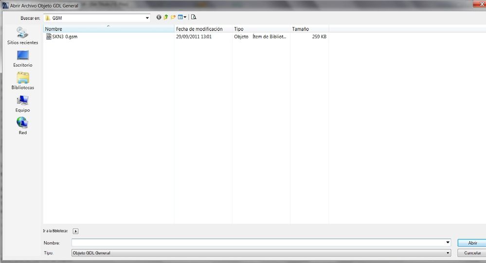

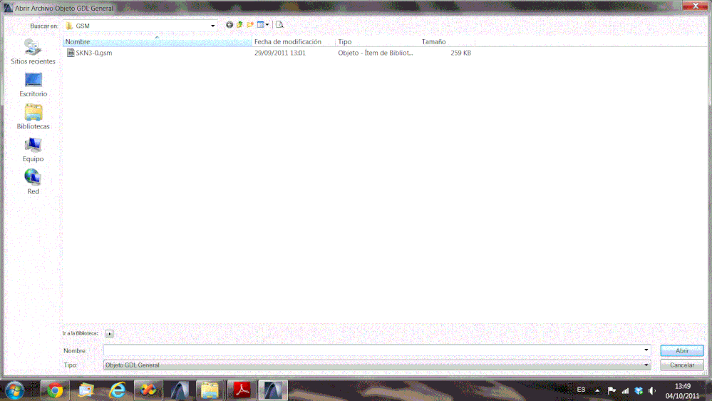

i would like to know if somebody can tell me how to call the dialog to select an object from the libraries(double click from the object icon in the left menu bar) from my API, i mean, the function which call this dialog. Thank you!

frankito5 wrote:Perhaps
Yes, that's exactly what i want but, there's a way to open the object directly from the windows browser? I show it in the picture. Thank you again!

Ralph wrote:
PerhapsDGGetOpenFile?
Could be, but I have included "DG.h" and "Location.hpp" and the compiler does not recognize 'DGGetOpenFile'.
IO::Location loc1 ("C:/Users/User/Desktop/Objetos Junkers");
DGGetOpenFile(&loc1);
Something wrong?

‎2011-10-05 12:31 PM
frankito5 wrote:The file you need to include is

‎2011-10-10 08:51 AM
Ralph wrote:Now, there is no errors with the compiler but, the "normal" open dialog is opened. What i want to open is a library object open dialog, so i can't use
The file you need to include isDGFileDlg.hpp
Alex

‎2011-10-10 08:36 PM
frankito5 wrote:Can you post a screen grab of the dialog you want to invoke?

‎2011-10-11 08:28 AM

‎2011-10-11 10:04 AM
frankito5 wrote:Isn't that a standard 'open' dialog?
Sure!
